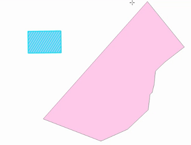

Step 1 - Perform one edit action - creating a new polygon or reshaping a polygon or splitting a polygon

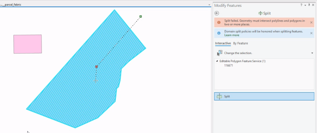

Step 2 - Select a polygon and select the Split tool .
Step 3 - Make an invalid split action (e.g, draw the split line totally outside the selected polygon or draw the split line half way through the selected polygon and finish it) forcing ArcGIS Pro to show an error message.
Once the ArcGIS Pro throws an error, abort this split.

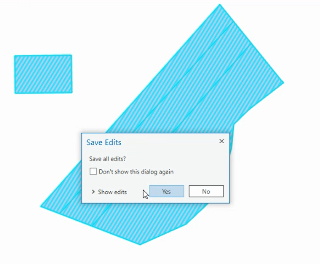

Step 4 - Next, make one or more valid split actions.
Step 5 – Note down the number of features with the attribute table. Save all edits.

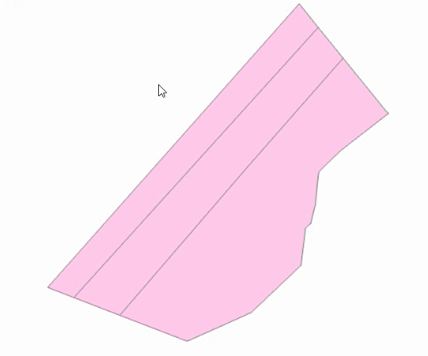

Step 6 – Switch to DEFAULT version and switch back to the user-created version. Observe the edit that you made just before the split error (Step 1 edit) has been Undone/Missing.
The workaround is to remember to save after every edit action or turn on Auto-Save after every edit action. Of course, you lose the ability to Undo in case if you would need to go back.
