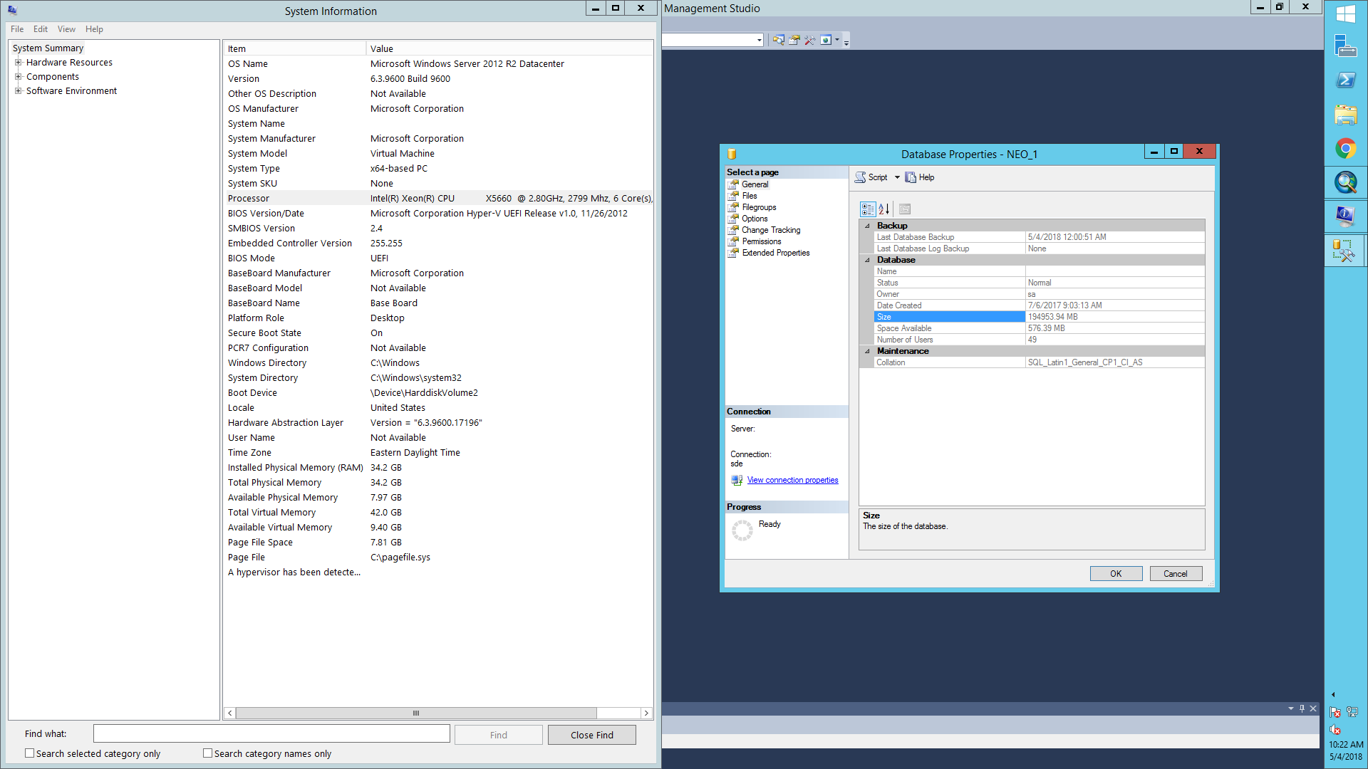

VM Machine specs w/ sql gdb

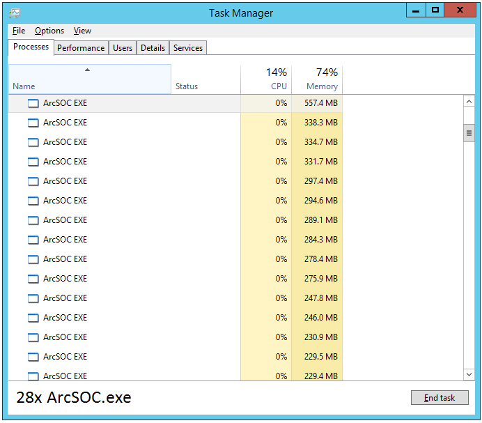

VM - Machine task manager
ThomasColson
MVP Alum
Based on the number of ArcSOC's running, I'm assuming you're spawning more than 1 or 2 feature services. ArcGIS Server and SQL are memory HOGS. I was in your boat a few years ago, and learned through painful experience to isolate each application of the GIS "stack" on it's own VM, and set the Hyper-V memory settings accordingly. There is no way you're going to get the performance you're expecting with SQL and GIS SVR on the same machine, with that many service instances (yes, even just 28). Trust me....kick SQL to its own VM, and a physically separate VHD if you can. If SQL and the GIS SVR Data store share a VHD, you're going to have the same performance problems. I went further and put the SQL log and temp files on physically unique VHD's, and saw further improvement. Another option would be to move your entire environment to a high-speed SAN...e.g. a Dual NIC QNAP with RAID 10. You're further limited by what appears to be 12 cores, not sure how your hyperv is set up, but Portal, SVR, and SQL (with 49 users!), you're really pushing the edge of the envelope. Just for giggles what happens when you turn off Portal in Services?
Would love to see how you fix this, but, the best recommendation you're going to get is to call Tech Support. I ended up getting ESRI tech support on the phone with the data center folks, and that's how we got it fixed.....
MichaelMiller2
I echo Thomas Colson‌ comments.  Isolation of applications is key. As well as increasing the number of cores(processor) and memory per machine will do wonders.
