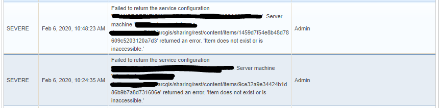

In ArcGIS Server Manager we are receiving some severe log messages that say "Failed to return the service configuration 'XXX'. Server machine 'XXX' returned an error. 'Item does not exist or is inaccessible.'
Can anyone help explain or trace why we would recieve this message and what we could do to fix it?

Have you checked the permissions on the Arcgis portal folder? Sounds like it may not have the correct permissions set.

Was this ever resolved? I am encountering the same issue. I checked the ArcGIS portal folder for the correct permissions.
