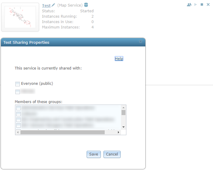

  5. Now is where we begin to see errors.  If I go back to the ArcGIS Server Manager appliction and open up the Sharing dialog in the Manage Services page, the sharing that I set in Portal does not show up.
    Further, if I capture the REST response from Manager to Portal for the URL
    https://portal.mydomain.org:7443/arcgis/sharing/rest/content/users/username@DOMAIN/items/0c77d43a865...
    I see a JSON response of
    {"error":{"code":400,"messageCode":"CONT_0005","message":"Item does not exist in this folder.","details":[]}}
    Share settings not shown in Manager

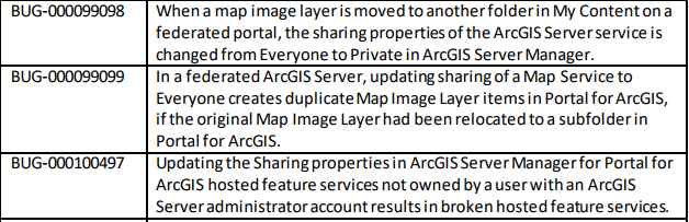

UPDATE
It appears that this issue I've run into is documented as a series of BUGs in 10.5 that were fixed in 10.5.1. Other than keeping Portal Service Items out of Portal folders in the short-term, upgrading appears to be the correct fix.
List of relevant Manager bugs
