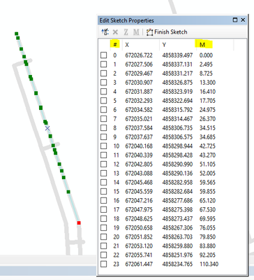

I have existing SDE.ST_GEOMETRY polylines that have M-values (aka 'measure values' for linear referencing purposes).

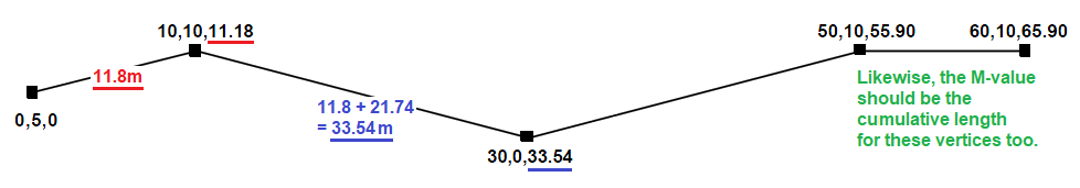

I want to UPDATE the M-values via Oracle SQL. In my case, the M-values should be the same as the cumulative length of the line. In other words, if we look at the image below, the M-values should be the same as the length of the line at a given vertex.
Using SQL, is there a way to set the M-values to the cumulative length of the line? I'm specifically looking for an Oracle SQL solution.

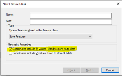

Actually no, I don't want to convert the vertices to points. I want to update the M-values that are stored in the vertices of the polyline. M-values are similar to the X, Y, and Z coordinates of a given vertex...X, Y, Z, and M are stored in the SHAPE column of the feature (not in numeric fields/attributes).

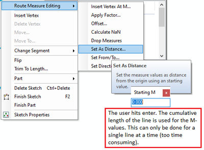

In our case, our M-values are always exactly the same as the cumulative distance of the line. If we could, we wouldn't even use the M-values, and just use the length of the line. But I don't think that's possible. So we want to find a way to automatically set the M-values to the cumulative length of line. If I can figure out how to do it with SQL, then I'll use that SQL to create a Oracle trigger that will update the M-values if a user creates a new line or edits the shape of an existing line. That would be a lot better than relying on a user to do it manually when creating or editing a line:
