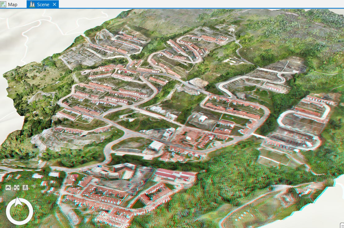

I am working with drone data to create 3d products over an area of ​​approximately 1.3 km2. The mesh was created in Site Scan for ArcGIS, it weighs approximately 11 Gb and from there I was able to view it without any problem, just like when I download them in SLPK format to view it in ArcGIS Pro.

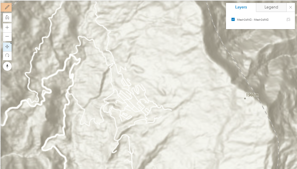

The problem is when I try to publish them to the portal, since the data loads as a hosted layer but it is not possible to visualize them as a scene since it stays loading but never allows to visualize them.
The publication to the Portal was done in two ways, from Pro with the Share Package tool, and also from the portal with add item. In no way could I visualize the Mesh as a scene. Although, having it in the portal and viewing it from the option to open with ArcGIS Pro, does allow me to view the mesh.
