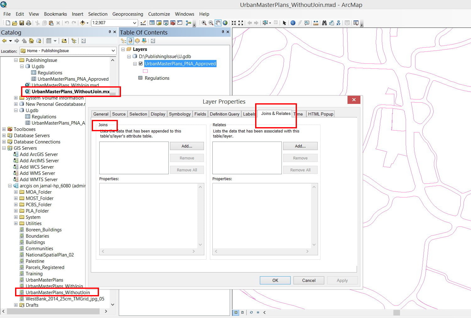

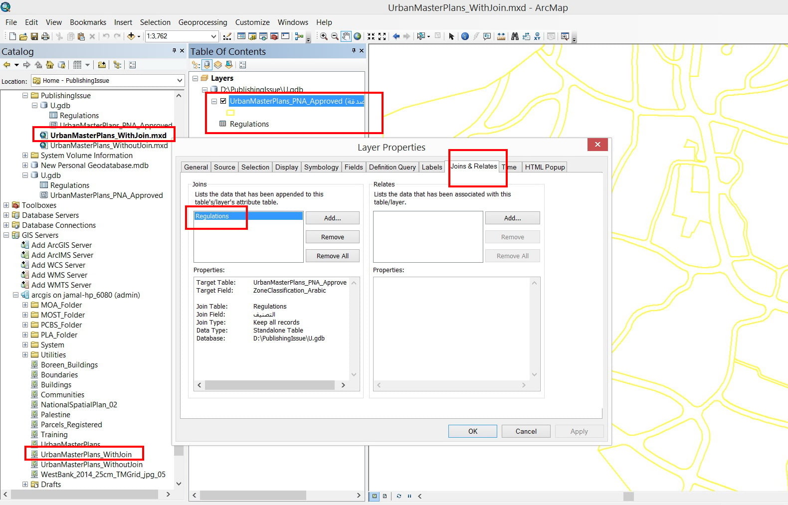

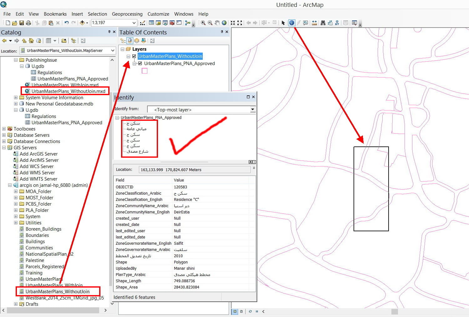

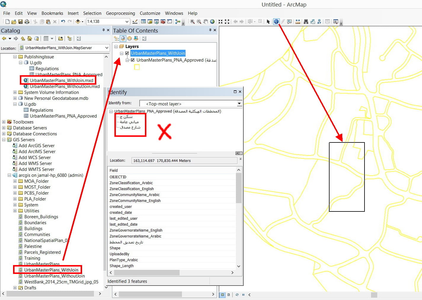

We couldn’t figure out why a service fail to provide correct identification for the selected feature. However, the scenarios below may highlight the issue:
  1. In the “UrbanMasterPlans_WithJoin.mxd” file, the attribute table of the “UrbanMasterPlans_PNA_Approved” layer is joined with the “Regulations” table, then the ArcGIS Server fails to identify all the selected features.
  1. In the “UrbanMasterPlans_WithoutJoin.mxd” file, the attribute table of the “UrbanMasterPlans_PNA_Approved” layer is joined with the “Regulations” table, then the ArcGIS Server is able to identify all the selected features.
Data:
http://www.mediafire.com/download/6j8a0ob26b57ou8/PublishingIssue.zip
What might be the issue here? Why the “join” affect the “identify” applied in a service?
