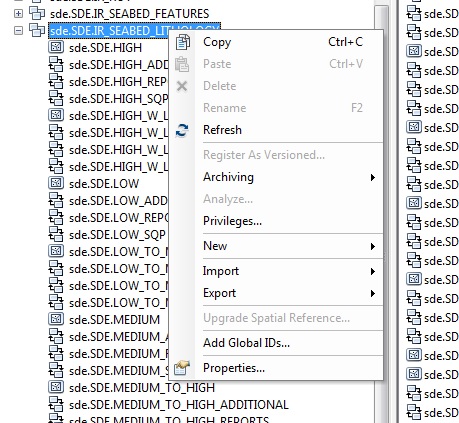

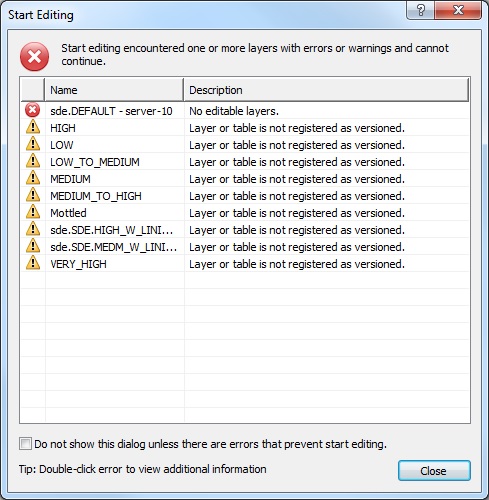

1 ) Feature class participating in one of the dataset is now not registered as version and can not be edited. Register as version command is not active in context menu.

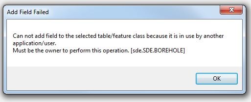

3)  During restore operation, sde login was mistakenly assigned to dbo user instead of sde user. Due to this all table operation (add field, delete field etc) can not be perform because the dbo is not the owner of database.

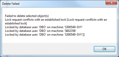

3 ) Cant delete a geodatabase table as the application throw an error of established lock however there is no user connected to database.
Kindly find attached here the screen shots of errors

I would recommend restoring the database again, and be sure to map the SDE login is mapped to the SDE user.

However, make sure that there are no Orphaned Locks in the 4 Lock Tables or Connections in the Process Information table.
For that Feature Dataset, you need to Unregister as Versioned and then re-Register as Versioned to edit the FCs in it.

I believe the users have to be restored or reset once the database is restored, make sure in your security in the database that the SDE user is the owner of the SDE schema and that the DBO user is the owner of the DBO schema.  They have to match.
