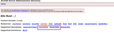

Darn, that's a shame. Do you have snapshot backups that you can revert to? What about webgisdr backups?
You could try taking a backup from the ArcGIS Server Admin endpoint (exportSite) and import it right back in (importSite). I've seen that fix weird issues w/ Portal.
You'll want to make sure you take a snapshot backup prior to importing, just in case.
