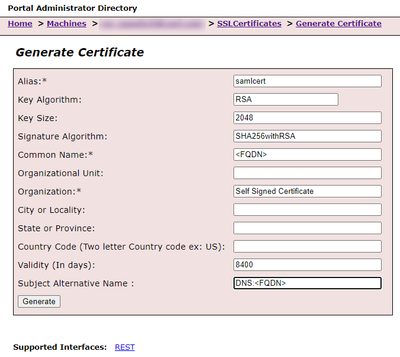

The samlcert alias is a self-signed certificate used for signing SAML requests to an external identity provider. Since it's self-signed, you can just use the 'Generate' operation from the machine endpoint of the Portal Admin API. I've attached the reference documentation plus a screenshot of the appropriate settings (just replace <FQDN> with your machine's fully-qualified domain name), that should put things back in place!
Generate a new certificate | Import a certificate into the portal | Portal for ArcGIS
https://enterprise.arcgis.com/en/portal/latest/administer/windows/import-a-certificate-into-the-port...
