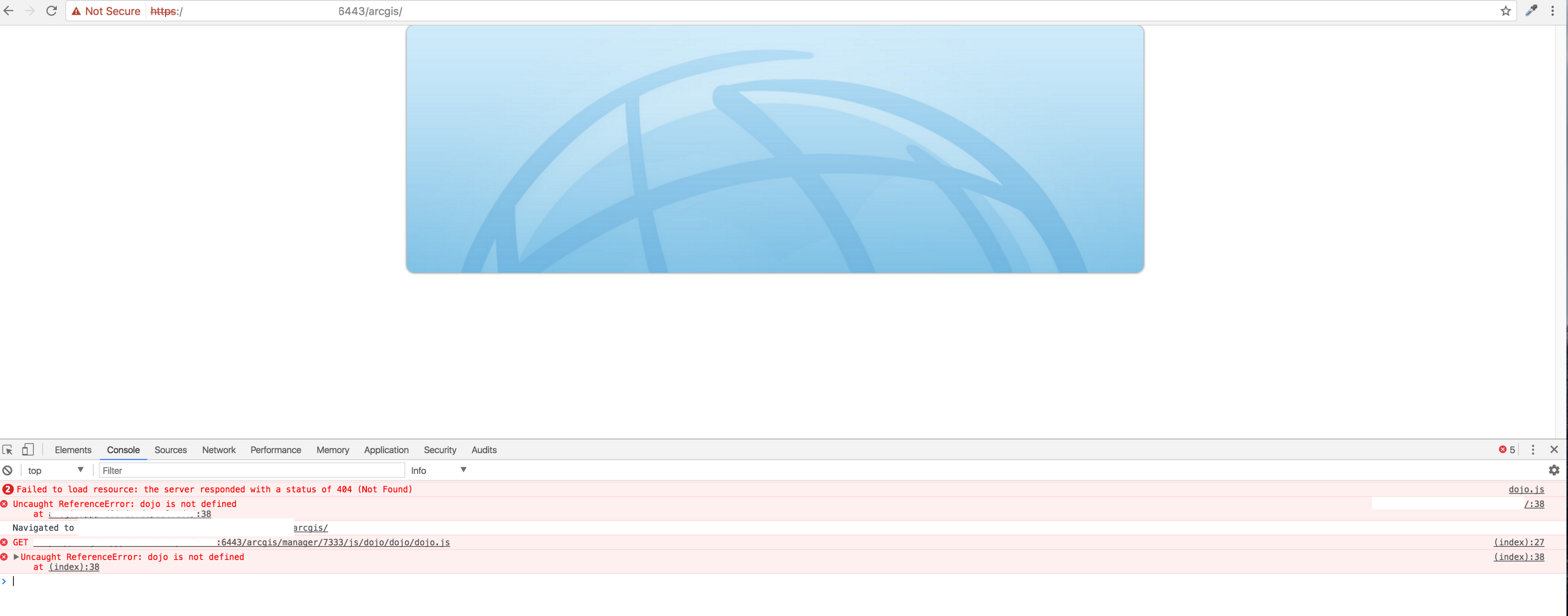

From the Portal machine, I can access the administration URL just fine... it is maybe worth noting, though that this is from 6443/arcgis/admin, rather than 6443/arcgis URL that the federation instructions suggest. Going to 6433/arcgis just leads to a splash page with a single image, as shown in the attached screenshot (along with errors finding and loading a script). I am going to look into what could be causing the errors on this page, but I'm suspecting now that since the script is failing to load, it may be preventing proper federation with Portal. If anyone has any ideas regarding this it'd be appreciated. Edited this post due to whole message not being posted. arcgis

Ok, so you've confirmed that your Server site is up and running because you can access it right? You can access the Server administration URL, but can you access and login to ArcGIS Server Manager?
The screenshot you posted suggested that the Server site resource cannot be found.

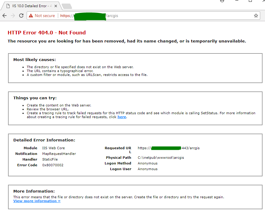

I have noticed that when I used https://<machine name>/arcgis/  'HTTP Error 404.0 - Not Found' (see attached), and going into c:\inetpub\wwwroot there is no 'arcgis' folder (just 'portal' and 'server'). Is there supposed to be a 'arcgis' folder there? I have 10.5.1.HTTP Error file not found ArcGIS Server

No, when you reach https://portal.domain.com:7443/arcgis/ or https://server.domain.com:6443/arcgis, the 7443 and 6443 ports are running on internal web servers and not through IIS.  You won't see an "arcgis" folder, (unless you've installed a web adaptor named "arcgis", which WILL use IIS).

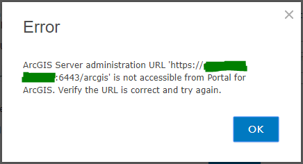

The error I am mainly referring to, is when I attempt to federate my server with portal (using the previously mentioned URL's), I get this error:
Federation of server and portal for arcgis error
It might be also useful to know that as this is just a pull-up pull-down environment for development work, I am using self-certification from IIS. I have tried a number of combinations (e.g. IP, localhost) along with the machine name (which this thread indicates is what should be used). But still get the error.
