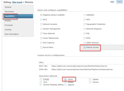

@Skysurfer publish the feature class(es) as a Map Service.  After it's published, go into ArcGIS Server Manager > click on the service > Capabilities > check Features Access with only Query capabilities:

Thanks everyone for the responses — you’ve all confirmed what I was suspecting.
@JakeSkinner, would it be possible to enable editing for the features? To give more context, the goal is to publish referenced layers from a file geodatabase (FGDB) to our portal, and then create a collaboration with AGOL that allows two-way editing of the source data. While we have an eGDB, we'd like to reserve the use of it for larger and more secure datasets.

@Skysurfer no, you cannot enable editing.  That would require the data to be stored in an Enterprise Geodatabase.
