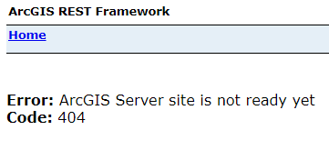

We have three ArcGIS Server nodes sharing the load for our map services.  In ArcGIS Server Manager > Site > Machines I have stopped one of the nodes:
The health check (:6080/arcgis/rest/info/healthcheck) for the stopped machine returns a 404 error:
However, If I look at the ArcGIS Server logs through the Admin interface (:6080/arcgis/admin/logs/query) I can still see log mesages from the stopped node.  Why doesn't the web adaptor recognize that this node is unhealthy and direct all of the requests to the other 2 nodes?  Looking at the last 1000 log messages, roughly 1/3 of the messages are generated by the stopped node.

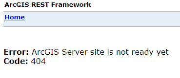

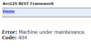

    I have experimented with the "Under Maintenance" flag and it appears to stop the web adaptors from sending traffic to an ArcGIS Server machine.  I was told the web adaptors do a health check about once every minute but I have not verified that.  Here is what the healthcheck will display when the "Under Maintenance" flag is set (left) vs. when a machine is stopped (right) on version 10.7.1:
    In my opinion, both situations should cause the web adaptors to stop sending traffic to an ArcGIS Server machine.
