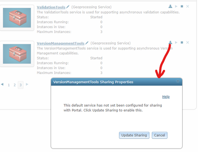

I published a web layer with branch versioned data from Pro to our Enterprise Portal's Hosting Server. The enterprise geodatabase is registered with the Hosting Server.
I go into the published service in Server Manager and see the same thing, where Version Management is greyed out, even though editing is definitely enabled.
I tried to Update Sharing of the System-VersionManagementTools geoprocessing service, but see no change and the sharing does not seem to take hold either. Nothing in the Server logs about this etiher.
