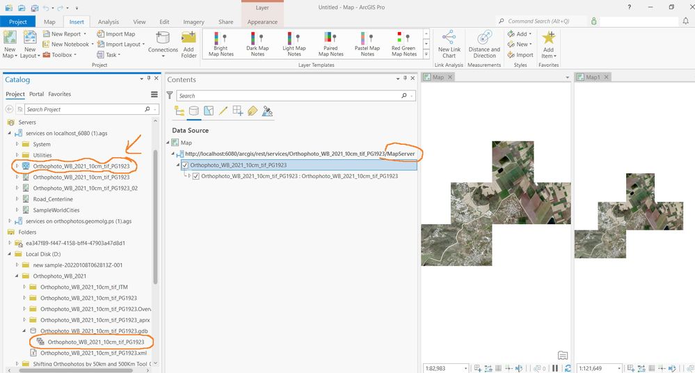

How about this in ArcGIS Server 10.9
Is cached service still much faster than mosaic published as images service?
Jamal Numan
