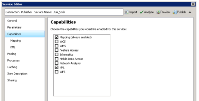

@Anonymous User I suggest you publish an additional service that uses your parcel fabric as the source data.  Assuming you are publishing the service from ArcMap you only need to enable the capability for "Mapping":
I beleive the above image shows the default capabilities.  There is no harm in leaving the KML capability enabled.  Without the "Feature Access" capability there is no possibility of editing the data.
