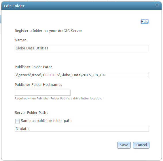

We've set up the data store (see screenshot) so that the network file GDB is duplicated locally, and I thought that the GP service would use the local workspace instead, but this clearly isn't happening.

This is a known issue with server 10.2.1 - NIM098733. It's fixed at 10.3 and I don't think there are any plans to backport to 10.2, so I'll have to upgrade, or keep editing the script after publishing.
