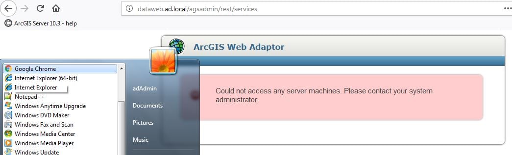

Hi,
I installed two web adaptor´s one no administrative and other administrative. Both with different names!
I´m using the same administrative account from AD for both web adaptor´s. But in administrative web adaptor (with administrative option checked)...I can´t acess yet!! My windows session is logged with the same user used in administrative Web Adaptor.
Somebody can help me?
Thank´s

That's not the correct error when administrative access is disable and you try to reach the Admin API or Manager. Can you reach https://server.domain.com:6443/arcgis/admin or https://server.domain.com:6443/arcgis/manager?
