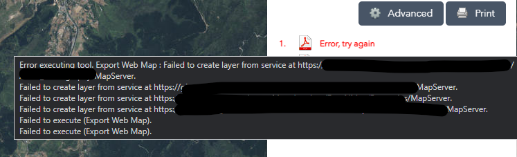

nacelle_pylon
I am having the exact same issue. Has there been a resolution to this? I am currently on enterprise 10.8.1
nacelle_pylon
here is a screenshot from one of my federated servers printing.jpgprinting.jpg
nacelle_pylon
Also just to add to this if I go to those layers and set the sharing to public and print the layers will work. If I set it back to organization sharing everything will work temporarily. Is it a certificate issue? Or some issue pulling data? I am not sure but it seems to affect chrome and possibly firefox.
