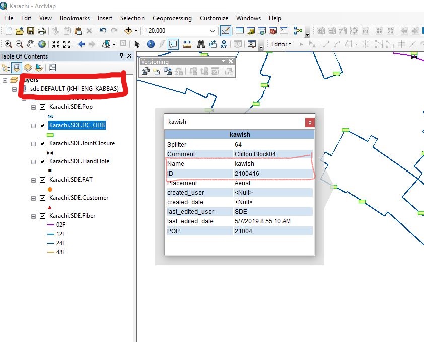

I am using sql server 2012 and Arcmap version 10.4.1.
My problem is that when i post data from Arcmap it will post to parent version easily but not show in the table of sql server.
Reconcile and post to default (Parent) version.
in above image i reconciled from child to parent version and post, it works successfully. i edit name filed which has mentioned in image.

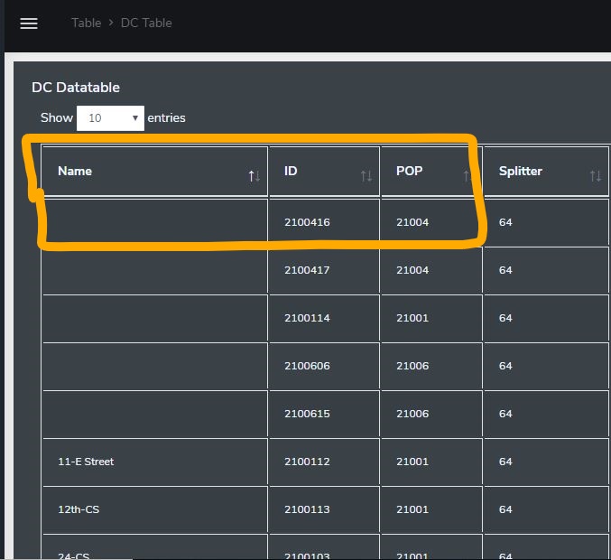

This is my Application in which i show all data in table format, you all can see there is no update of name filed.

It sounds like the versioning is working as designed. The edit may not show up in the base table till you run a compress; https://desktop.arcgis.com/en/arcmap/latest/manage-data/geodatabases/the-compress-operation-and-geod...
Run the compress and see if the edit is moved to the base table and report back.

Or refer to the versioned view created from that Feature Class in your Application...
