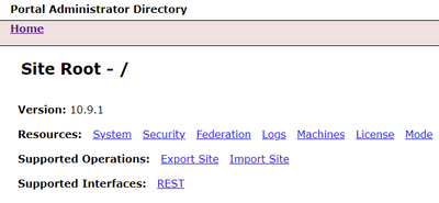

When I go to "https://portal.host.machine:7443/arcgis/portaladmin/" I see below screen.
I have tried on different browser (Edge, Firefox, Chrome, IE), same result.
I have no error in the portal logs.
Do you have any idea to solve the problem?

You're right! i just had to click on the login button.
Thank you for your help.
