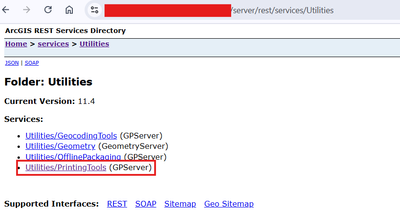

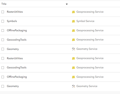

the printing tools are not shown in the utilities folder in the portal content.
kindly advise how to find or re-add it to the portal content. noting that it is existing in the services directory.
TimoT
Hi @ElieRizk,
I've had to do this before.
Go to Portal > Content > New item > URL, then input the REST URL of your printing tools geoprocessing service e.g. https://server.domain.com/server/rest/services/Utilities/PrintingTools/GPServer
You will additionally need to edit the PrintingTools service json so that it references the correct Portal item ID, otherwise you will encounter some permissions related quirks for non-administrator users. To do this:
  1. Login to Server Admin Directory (e.g. https://server.domain.com/server/admin) for the ArcGIS Server that hosts your printingtools
  2. Navigate to services > Utilities > PrintingTools.GPServer > edit
  3. Find the itemID parameter in the JSON code and edit with your newly created PrintingTools item ID.
  4. Save your edits
