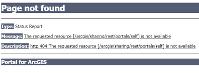

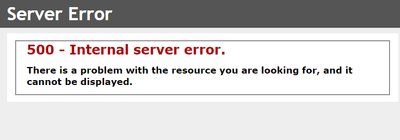

I just upgraded from ArcGIS Enterprise 10.9.1 to ArcGIS Enterprise 11.0 today and everything was going well until I installed the Portal for ArcGIS Security 2022 Update 2 Patch. After installing the patch, I am getting HTTP 500 errors through the web adaptor URL and HTTP 404 errors through the internal URL. I uninstalled the patch, and everything started working again. Reapplied the patch and the errors came back. I am not seeing anything useful in the web traffic or logs to determine the cause.
Is anyone else experiencing this issue?

I experienced the same issue in our 10.9.1 environment just a few minutes ago. Restarting the VM didn't help. What fixed it in my case was restarting the IIS server. Just open IIS Manager, click your connection on the left side of the page, then click Restart on the right side of the server.
Edit: To clarify, I experienced this after installing the same update giving you issues.

@RyanUthoffthank you for the suggestion. I tried restarting the IIS server, the Portal for ArcGIS service, and eventually the entire server. As long as the patch is installed the pages will not resolve.

@DorothyMagulithe port is open and I have not changed the certificates. I tried clearing the browser cache and cookies in three different browsers but as long as the patch is install I get the errors. Uninstalling the patch allows the pages to resolve again. I have tried applying the patch twice now with the same results.

@George_Thompsonthank you for the suggestion and I have done so. We were running the same patch (version B actually) on 10.9.1 without any issues.
