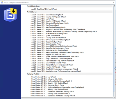

Hi,
after patching installation with dedicated utility
and after a serveral restart, portal does not respond.

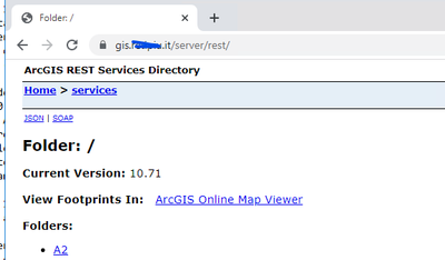

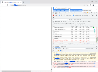

This is what i see in my browser (cache cleaned)
rest respond
but when i navigate in a service...
This is a single machine deployment and I never seen this type of error
Have you any suggestion?
