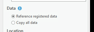

David thank you for your response. BTW this is supposed to be categorized under ArcGIS Online not ArcGIS Enterprise, but we have the same issue for both. So if the previous staff selected "Copy all data" that's what you are referring to?
 and therefore that's why we can see data?

So I explored the path you suggested and YES, some of the services do have the .mxd within the path:
<drive>arcgisserver\directores\arcgissystem\arcgisinput\Map\Map.MapServer\extracted\v101
but not all. So i'm assuming those that do not have the copied project files chose "Reference registered data" radio button?

DavidPike
MVP Notable Contributor
I would say so, but best to get a second opinion as I get confused regularly by some quirks.
