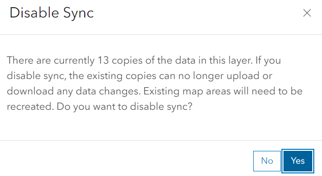

I am thinking it is failed replicas to your mobile devices that is causing the problem, because of the large sync volume, check this buy checking off sync it will tell you, you have x replicas waiting to replicate, but don't save the setting please make Backups before any changes.

I tried to disable sync for one of our main layer. I've the message below, but I guess it is because I created a few views from this master layer.
