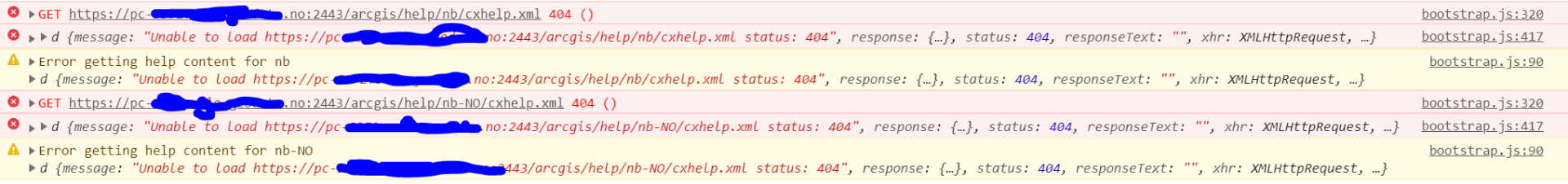

Get Error msg 404 unable to get ...:2443/arcgis/help/nb/cxhelp.xml
