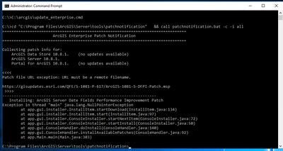

I realized that if I run the patchnotification from the task scheduler I always had an installation left to install.
So I ran the cmd file and discovered this
why doesn't it install?

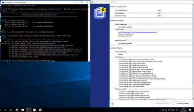

I noticed just this because I compared the command line with the gui

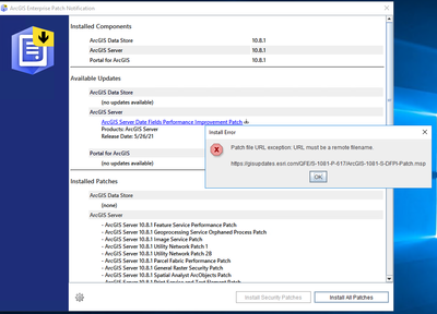

for the sake of it I tried to upgrade through the gui and the same error appeared.
Thanks for reporting the Bug number.
