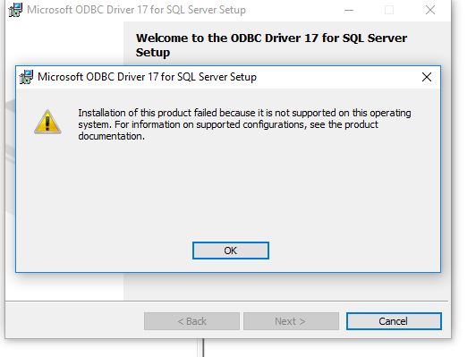

I downloaded the odbc 17.3.1.1 driver and tried connecting but get the generic 'unable to connect' message. I have 10.6.1 on my laptop. Others have 10.5 or 10.7 Desktop.
TravisJowell1
I can't install the 32 bit driver for some reason on Windows 10...
George_Thompson
Esri Notable Contributor
I would install the 64-bit regardless of the O/S bit level.
Report back the results of the 64-bit driver.
--- George T.
TravisJowell1
I did that first. Getting the generic 'cannot connect' error from catalog.
On the SDE host I connect with same credentials and it works fine.
