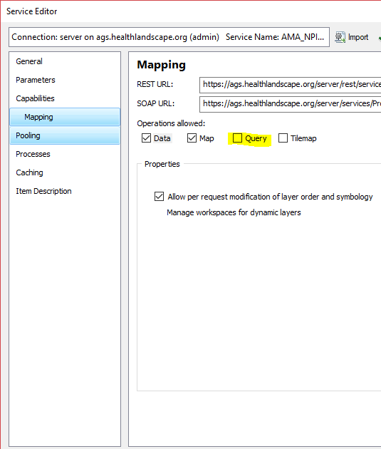

I have a service with three layers that I publish to our Enterprise 10.6.1, from ArcMap 10.6.1. I know that when I publish the service from my MXD, I can check/uncheck the box in the Mapping Capabilities window:
But this will turn it off for all layers, correct? I would like to turn it off for one layer and leave it on for the other two in the service. Am I able to do that, either at the MXD level or at the Portal Manager/ArcGIS Server Administrator Directory level?

Hi Dave,
