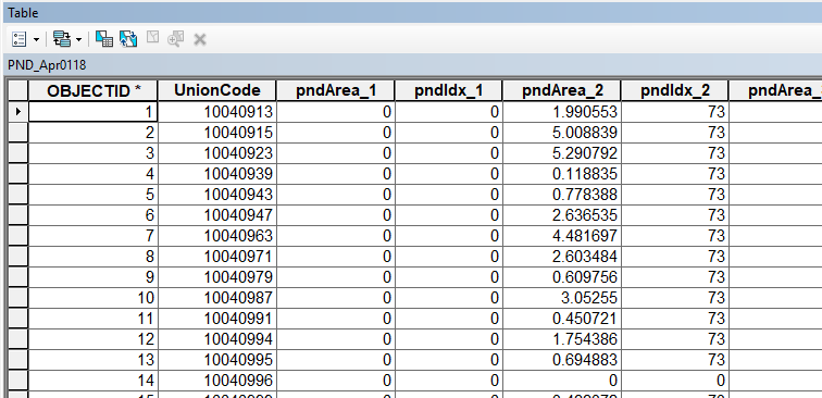

  • there is a 'pest status' table (see pic) for each administrative polygon with the same unique ID (UnionCode). These tables (ie. PND_Apr0118) are created every day and stored inside a geodatabase
  • there are about 11 pest indices (pndIdx_1, pndIdx_2, ...) and their respective area coverage percentage (pndArea_1, pndArea_2, ...) stored inside each table. At the end, there is a column storing the date of the data and the date of the table creation. pndIdx_1 = Yellow Stem Borer, pndIdx_2 = Brown planthopper etc (this could also be 11 separate timeseries map, or one map with 11 toggle-able layers)

1. The 'pest status' table has 5000+ rows referencing the admin polygons using the key 'UnionCode'
2. the new data is a separate table with the same 'UnionCode'. This means all 5000+ rows have an update everyday (every administrative polygon gets a pest forecast that changes with weather), this means everyday a new table. If this changes are to be inserted in the same table the table will get huge
