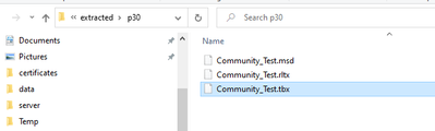

If none of these options are for you and you just need to find the resources of your previous geoprocessing tool, you will need to access the VM running ArcGIS Server to grab the following files. WARNING - do not use this directory to work with the data. Copy the required resources away from this location.
The example directory below contains the toolbox (.tbx) which was used to publish the service - in your situation, depending on the geoprocessing tools requirements, you may find all required resources in this directory.
C:\arcgisserver\directories\arcgissystem\arcgisinput\Community_Test.GPServer\extracted\p30

Once you've copied those files away from that directory, you will be able to use the Desktop client (ArcGIS Pro) to publish the Tool contained within the .tbx (you can expand .tbx in ArcGIS Pro).
To publish the tool, you will need to run it and publish the result from the Desktop Client. Here's some documentation: https://pro.arcgis.com/en/pro-app/latest/help/analysis/geoprocessing/share-analysis/publishing-web-t...
