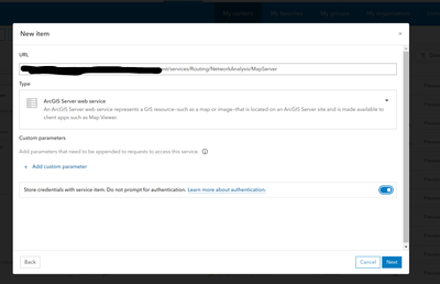

You could use the below method to create a Proxy item in ArcGIS Online (I personally call these proxy items - not official nomenclature). Be sure to Save credentials with this item in ArcGIS Online, as per screenshot below).
https://enterprise.arcgis.com/en/portal/latest/use/connect-secured-services.htm
This will allow you to share the "Proxy item" publicly/ with various groups, while you have a secured item internally.

C) "Proxy item" creation:
- Only works for Feature Services?
- Does not work, if 2FA is enforced in the deployment the service originates from
- Does not work in ArcGIS Online, if the source deployment is not exposed to the internet

C) Works for Map image layers, geocoding and Network analysis layers.
I'm not sure whether Maps or Apps can also be created as "proxy items" - I don't have a external facing Portal at the moment to test this.
- Does not work, if 2FA is enforced in the deployment the service originates from - Correct I don't think this would work. You can however disable 2FA for certain accounts https://enterprise.arcgis.com/en/portal/latest/administer/windows/manage-members.htm#ESRI_SECTION1_E...
- Does not work in ArcGIS Online, if the source deployment is not exposed to the internet - Correct
