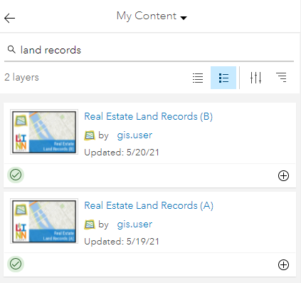

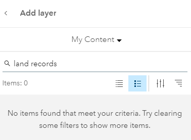

Search for Layers doesn't work for referenced map image layers or image layers for us at 10.9.  See the screenshots below.  Using the same keywords in classic and beta, classic returns expected services, beta returns nothing.
Beta
Classic
