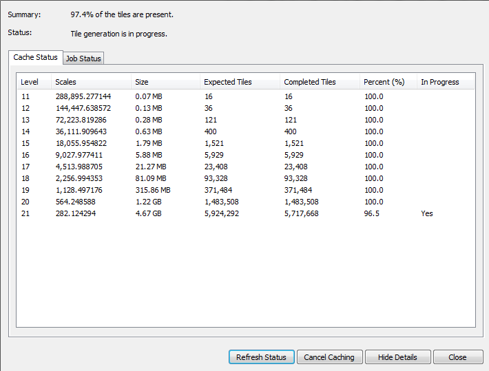

I am building a map cache from some property parcels that we maintain, and when I am trying to cache them, the process stops just before it's finished.
I have tried restarting the process, I have tried to recreate empty tiles, I have deleted it and started from scratch, but nothing seems to let me actually finish creating the cache.
Does anyone know what the problem may be? The Job Status pane shows that it is completed without any errors, but I have missing tiles in my map cache.

I updated them again, and just used a polygon to specify the extent in which I made my changes, and everything is working fine now. It looks like some hiccup happened, but now I will just update whichever areas I actually edited, instead of rebuilding the entire cache.

The status.gdb should give you an indication of which areas were not fully generated, so you can focus on either using an AOI as mvolz47‌ mentioned or determining if there's a different problem in that area.  You can also just zoom into the area in the Javascript API or another client application to see if tiles are actually missing.
