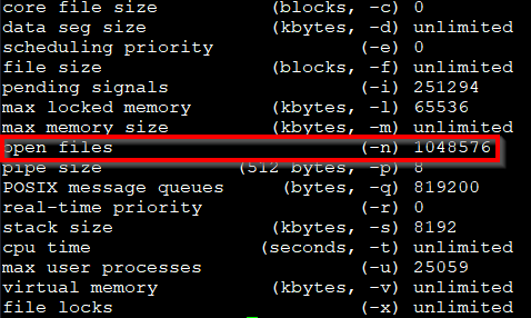

I got exactly the same issue on setting the Nofile and Nproc limits in the /etc/security/limits.conf file.
I have followed exactly the same procedures stated in the Esri documentation and set the nofile and nproc in the limits.conf file, however, nothing changed after login/out. I don't exactly get which step(s) is still missing for handling the limit requirements in my work.

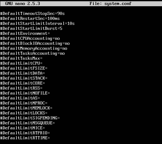

MkbRMIT
@StevenBowden Thanks for your response.
I don't use Systemd start up script and so have no install path directory.
I have also edited /etc/systemd/system.conf to set DefaultLimitNOFILE=1048576 and DefaultLimitNPROC=25059 in order to handle nofile and nproc limits. Still, the issue is in place and nothing changed.
It's not still clear to me where linux imposes its own limits except /etc/systemd/system.conf and /etc/security/limits.conf files.
