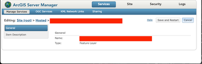

However, this is what I observe in our server manager.

Hosted feature layers are created when you publish directly to the Portal's Hosting ArcGIS Server. These are stored in the Portal's Relational Data Store.  If you want to manage their properties, you do so through their Item page in the Portal's Content. Even though they appear in the Hosted folder in Server Manager, they are not managed through that interface.
