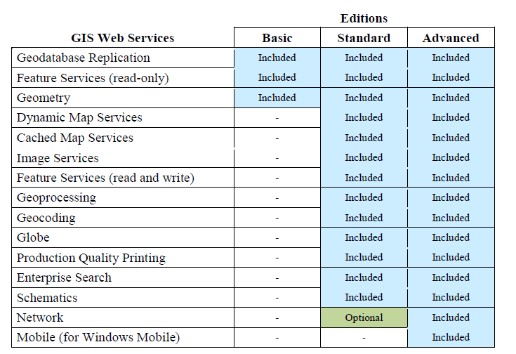

Just to let you know, after updating the ArcGIS Server 10.1 license to Standard instead of the Basic one I had been using I could publish the map and the error message "Layer's data source is not registered with the geodatabase"  did not show up anymore.
So the problem is this case got solved. I was not aware of the ArcGIS Server Basic license limitation regarding this functionality.
Thank you all for the support and suggestions. This is part of the functionality matrix for ArcGis Server just in case anyone face a similar issue that can be view in here: links.esri.com/esri-arcgis_server_product_functionality_matrix
