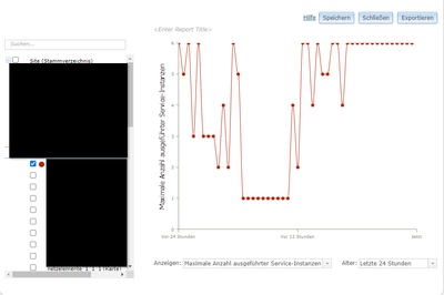

Thanks for your reply. Is there a way on how to check how many instances the service used over a period of time? The statistics module in the arcgis server manager doesn't operate well in my opinion.
For one of the services the max instances is shown for 6 instances. In fact the max. instances for this service is set to 6, but I have 2 servers operating in the site, means 12 instances. And currently I see 8 active instances. So the number does not correspond to what's going on.
