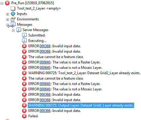

Hi There,
I have a GP model that does some analysis and adds few columns in the feature class. I ran this model successfully on my local machine and after that I published this model as a service. The model was published successfuly as well. When i use this GP service and use the featureclasses that are located on my machine, service comes back with an error. I am not sure if GP service can make change to a feature class that is local on my pc. Appreciate any feedback. Thanks Jay

The ArcGIS Server account needs at least read access to any data you're trying to use within ArcGIS Server, so you're most likely right in that it can't see the data on your local PC.  Can you set the messages to Info for the geoprocessing service under Parameters and reply back with an image of the error you get?

Hi Jon, Thanks for the feedback. These are all the errors that I get, seems a lot. The same model ran fine while runing from desktop, Appreciate your input.
Thanks Jay
