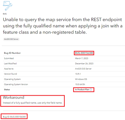

@HeathClark - Esri Technical Support status on the BUG.
BUG-000149858 - The Join name and Destination table name contain a percentage symbol (%) after creating a join between a feature class and a stand-alone table in ArcGIS Pro.
https://support.esri.com/en-us/bug/the-join-name-and-destination-table-name-contain-a-perc-bug-00014...
Duplicate of BUG-000156380: This bug does not state a problem. The query layer naming of joined tables using the % is general to all enterprise databases. The associated issue, BUG-000156380, indicates a publishing problem that some may be experiencing.
Status: Duplicated.
BUG-000156380 - Unable to query the map service from the REST endpoint using the fully qualified name when applying a join with a feature class and a non-registered table.
https://support.esri.com/en-us/bug/unable-to-query-the-map-service-from-the-rest-endpoint-bug-000156...

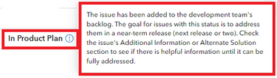

Status: In Product Plan
Workaround: Instead of a fully qualified name, use only the field name.
