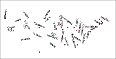

In ArcMap I am able to use the Maplex labeling engine to rotate labels on a point layer. I can then publish this MXD to become a Map Image Layer (MapServer) in ArcGIS Enterprise (Server) and the labels in the service display the label rotation.

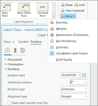

If I try this same thing in ArcGIS Pro with the Maplex labeling engine turned on my label rotation displays properly in the Pro APRX project but the resulting Map Image Layer displays the labels horizontally (i.e. the rotation is removed). If I change the Pro labeling engine back to the Standard one and publish as a Map Image Layer then the rotation works. Though now I loose the enhanced capabilities of the Maplex engine.

Would you mind try on a new version of ArcGIS Enterprise? I just tried on 10.9.1 and it worked for me, unless I missed any critical steps.

The steps I did were:
- Create map in Pro (APRX) with a point layer coming from MS SQL Server.
- Create labels and using Maplex set up rotation based on an attribute field.
- Publish to ArcGIS Enterprise (Server)
- In Enterprise 10.7.1, the rotated labels flip back to horizontal (rotation is removed)

I tried attribute rotation too and that worked for me as well. No rush, please give the newer version a try when you get a chance and let us know what you find.
