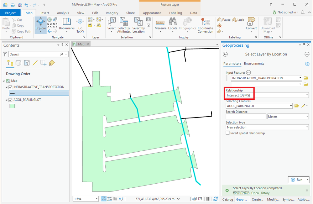

Select Layer By Location (Data Management) docs, the Relationship Parameter — Intersect (DBMS) section says:
For the Relationship parameter, the Intersect (DBMS) option may provide better performance than the Intersect option when using enterprise geodatabase data; however, this option is only supported under specific conditions. If all conditions are met, the spatial operation will be performed in the enterprise geodatabase database management system (DBMS) rather than on the client.

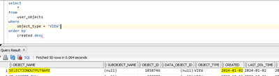

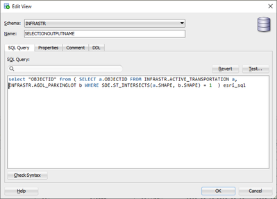

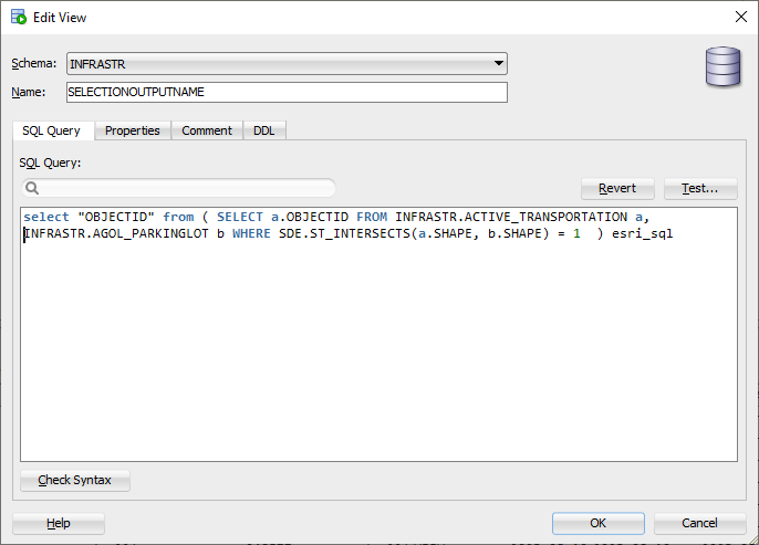

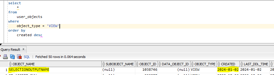

In other words, the tool creates a database view called SELECTIONOUTPUTNAME.
select "OBJECTID" from ( SELECT a.OBJECTID FROM INFRASTR.ACTIVE_TRANSPORTATION a,
INFRASTR.AGOL_PARKINGLOT b WHERE SDE.ST_INTERSECTS(a.SHAPE, b.SHAPE) = 1 ) esri_sql
