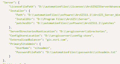

@CoryMarino you will want an additional web adaptor to access the new Image Server.  This additional web adaptor can reside on the same server where you host your Portal and ArcGIS Server web adaptors.
I believe you'll receive an error if you have two nodes configured with the same Role (i.e. "Server") in your JSON file.  Also, you may need to configure different directories for the Image Server vs your traditional ArcGIS Server instances.  In a single JSON file, there's only one place to define this:
