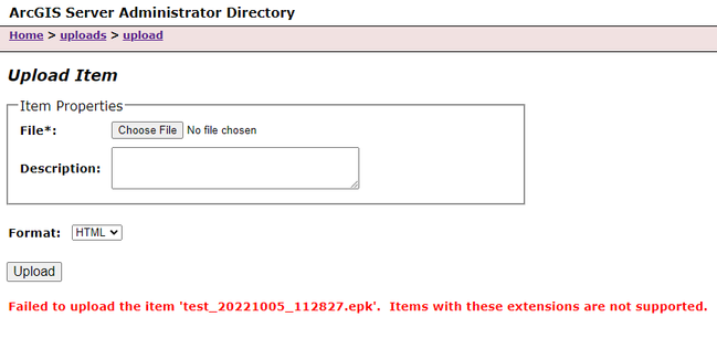

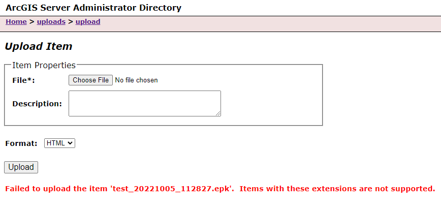

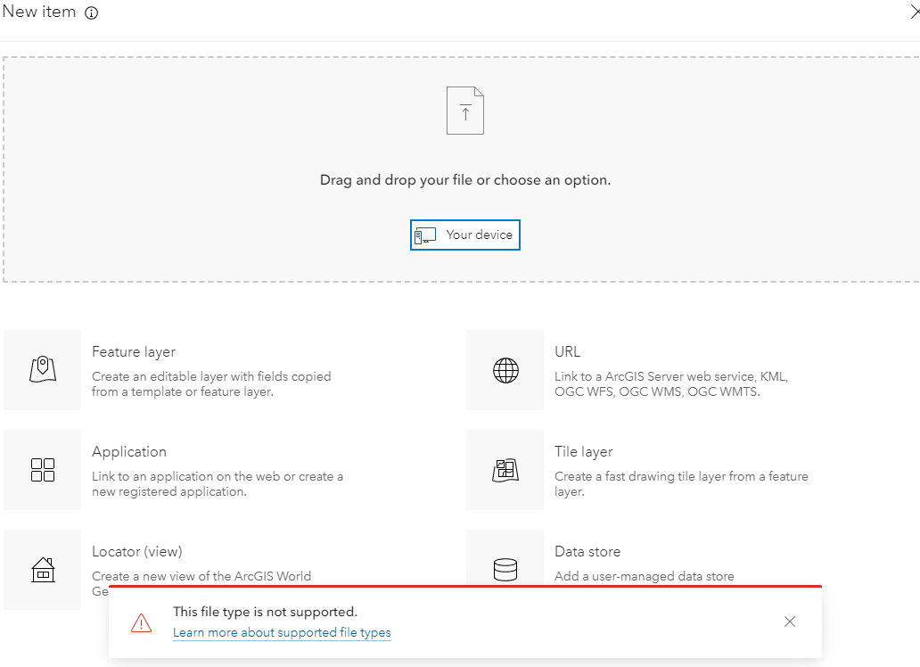

I am doing some test using export and import groups data. I was able to export a group content and download it  as test_20221005_112827.epk and when I am trying to do the exercise to import the epk file to other portal, fist I use add new item option in order to get item id for import and I got this error.
I also tried to do this from Server admin api and I got the same error.

epk file needs to be zipped before upload.  You can also import it through ArcGIS Server backend, following this guide: https://www.esri.com/arcgis-blog/products/arcgis-enterprise/administration/moving-content-across-tie...
