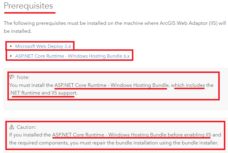

@KirkWebb - please open a ticket with Esri Technical Support to investigate further.
I am adding the links below as reference in case someone else runs into an issue.
Esri Technical Support - ArcGIS Web Adaptor (IIS) 11.1 requires <PrerequisiteSoftware>. Please see t...
ArcGIS Web Adaptor 11.2 system requirements
