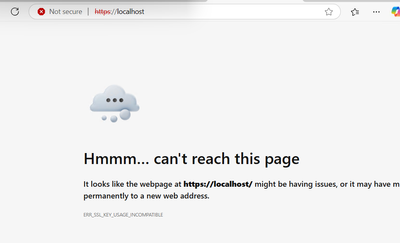

However none of these troubleshooting works, and every time I open HTTPS://localhost or HTTPS://FQDN it gives me:
Hmmm… can't reach this page
It looks like the webpage at https://localhost/ might be having issues, or it may have moved permanently to a new web address.
ERR_SSL_KEY_USAGE_INCOMPATIBLE
as shown in the following S.S.

Quick update:
I resolved the issue by running a simple PowerShell command (as Administrator) to generate a new personal SSL certificate for IIS. After that, I updated the HTTPS binding on port 443 with the newly created certificate — and it worked!
New-SelfSignedCertificate -DnsName "localhost" -CertStoreLocation "cert:\LocalMachine\My" -FriendlyName "IIS Localhost Cert" -KeyUsage DigitalSignature, KeyEncipherment -Type SSLServerAuthentication
I’m still not sure why it fixed the problem, since both certificates appeared to be of the same type. But for some reason, this one was accepted without any SSL compatibility errors.
