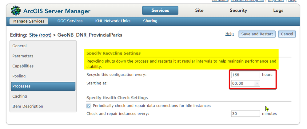

        Could this be the cause of the problem? By default all services are set to "recycle" at midnight.  This value can be adjusted when publishing a service or in Server Manager:
This doesn't quite fit with your description of "3 times over past 4 months at random times" but it may be related.
