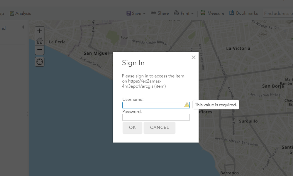

I installed ArcGIS Enterprise, Portal and server works fine but when I tried to access items from portal folder I receive a warning saying to sign in to access the item. Did I miss some config?

it looks like you're using a hostname in the 'web map':
   ec2amaz-4m3apc1
you would typically using a fully-qualified domain name there:
   ec2amaz-4m3apc1.domain.com
the fully qualified domain name is typically trusted whereas the hostname is not.  Have you got an alias to use?  That's a particularly gruesome URL otherwise.  I strongly recommend create an alias before you start loading any content.  e.g. mygis.domain.com.

Just to add to Scott's answer, if this is a new Enterprise and you've registered the web adaptor for Portal and Server - you may need to amend the web adaptors to use a friendly DNS alias on the registration page. Please see:
https://enterprise.arcgis.com/en/web-adaptor/latest/install/iis/configure-arcgis-web-adaptor-portal....
