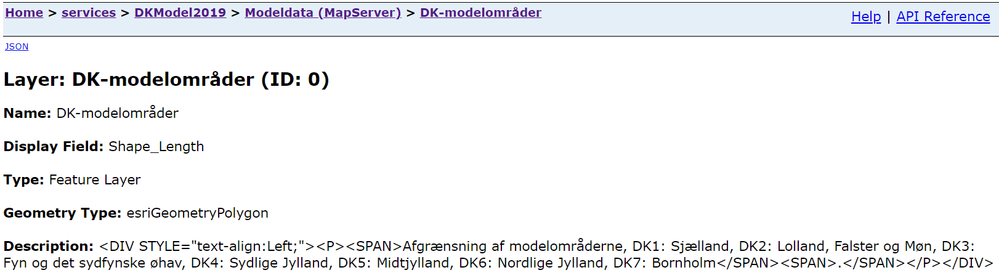

When adding a description to a layer's metadata and publishing as a Map Service to Portal, the rest endpoint shows the HTML tags for the Description and makes it very difficult to read. Is there a way of removing these tags or converting the description field to a simple plain text box? This isn't the case for the summary field.
Otherwise, is there a better way of viewing individual layer metadata for a multi-layer map service other than via the rest endpoint?

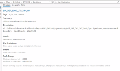

@MCameron this is from the layer metadata in Pro, being viewed in the REST on the web.
So in this example, i have a layer in my service with the following metadata:
We want the metadata for our individual layers to persist through to Enterprise, but the only way to view the Description for the individual layers is in the REST (unless someone can correct me otherwise?).
Obviously it's not easy reading the text in the description when it's wrapped in HTML tags. So is there a better way of viewing the metadata on the individual layers? or a way of making the description field plain text (does that remove the html tags?)

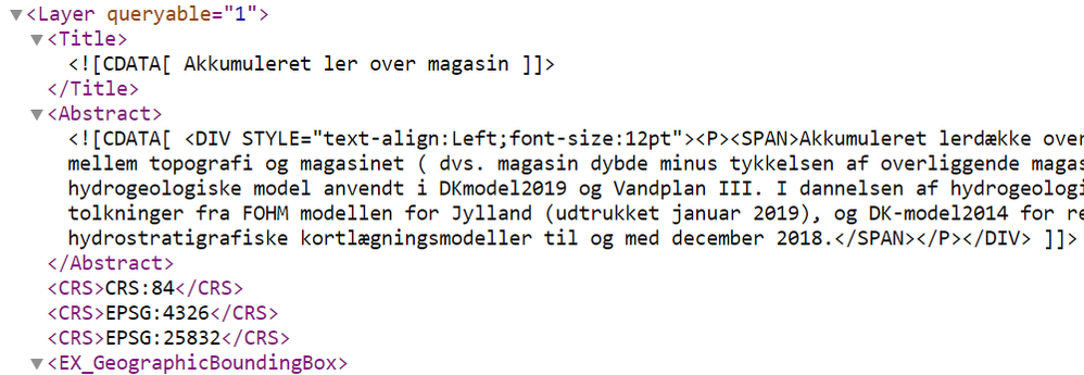

We are also encounting this problem and haven't found a way to remove it. It's a problematic issue that is causing a mess in the GetCapabilities info of the hosted service. The Enterprise portal is not involved in this.
<Abstract>
<![CDATA[ <DIV STYLE="text-align:Left;font-size:12pt"><P><SPAN>
The service was hosted from ArcGIS Pro v. 3.0.1 to our ArcGIS Server Site through an ArcGIS Server Connection (.ags).
Christian Brogaard Pedersen

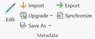

We have found an workaround for this issue which is unfortunately time consuming as every layer has to be updated with this method.
The workaround is to select the affected map or layer in the Catalog View and do an Export of the metadata to an xml file. We used the FGDC CSDGM format. Then do an Import for the same affected map / layer with the exported file and republish the service.
After this we could confirm that the issue with the HTML TAG disappeared from the map service.
